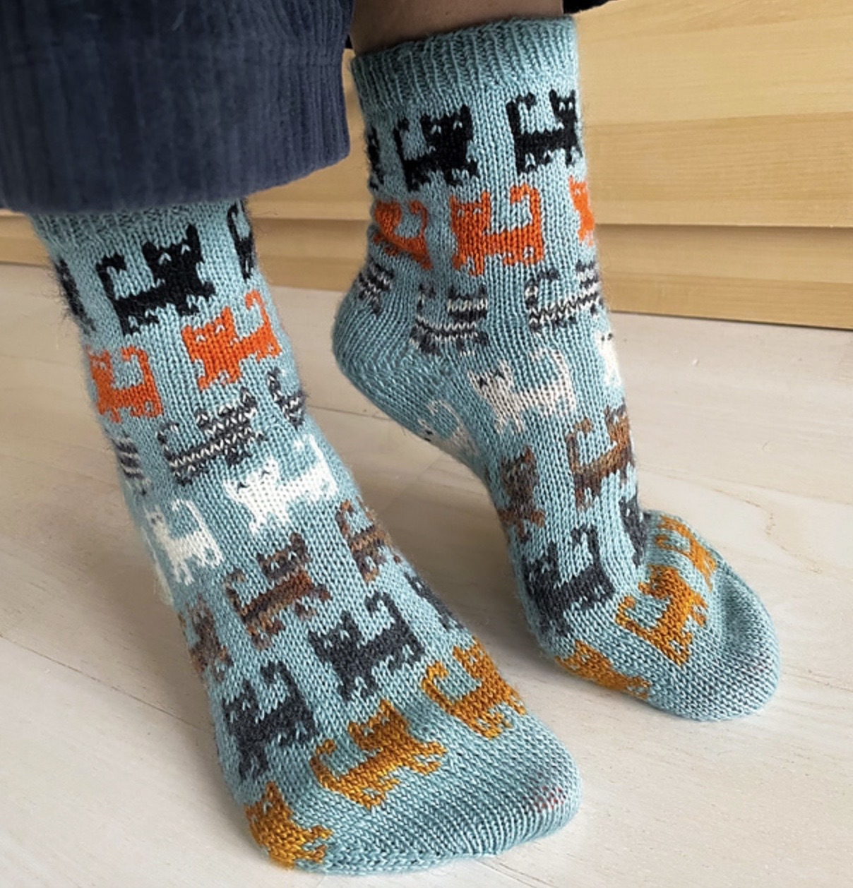

    Носки Herding Cats (Stone Knits)
    Перевод описания на русский язык.
    Sizing
    1 (2, 3)
    To fit (foot circumference): 19-20.5 (21.5–23.5, 25.5–27.5) cm / 8 (9, 10½) inches
    Finished circumference: 17.5 (20, 24.5) cm / 7 (8, 9½) inches
    Recommended ease: Approximately 2.5cm (1 inch) of negative ease. For your foot circumference, measure around the widest part of your foot.
    Further sizes can be achieved by going up or down a needle size.
    Leg/foot length can be easily adjusted. See instructions for details.
    Sample shown is knit in size 2 for shoe size US 8.5 (EU 39, UK 6), foot circumference 22.5cm (8 ¾ inches).
    MATERIALS
    Yarn - Fingering weight 4ply sock yarn
    Lang Yarns - Jawoll sock yarn. 75% Virgin wool superwash, 25% Nylon. 210m / 230 yds per 50g.
    Any fingering weight sock yarn can be used for this sock pattern, as long as you can obtain the same gauge.
    Shown in:
    MC: Acqua 372. Lang Yarns Jawoll sock yarn.
    Approx 50g (60g, 65g), 210m / 230 yds (252m / 275 yds, 273m / 299 yds)
    CC: Various scrap sock yarn from stash. Approx 5g per set of cats if you choose to knit different colour cats or 35g, 147m / 160yds in total for the pair of socks.
    Needles
    For ribbing and stockinette all sizes: 2.25mm (US 1), 80cm (32 inch) circular for magic loop, or DPNs, or two circulars or a 23cm (9 inch) circular needle as preferred.
    For colourwork size 1: 2.75mm (US 2), 80cm (32 inch) circular for magic loop, or DPNs, or two circulars or a 23cm (9 inch) circular needle as preferred.
    For colourwork size 2 and 3: 2.5mm (US 1.5), 80cm (32 inch) circular for magic loop, or DPNs, or two circulars or a 23cm (9inch) circular needle as preferred.
    Important note: Do check your gauge for fitting. Further sizes can be achieved by going up or down needle sizes.
    Gauge
    32 sts x 36 rnds = 10cm (4 inches) for colourwork size 1.
    34 sts x 38 rnds = 10cm (4 inches) for colourwork size 2 and 3.
    36 sts x 44 rnds = 10cm (4 inches) for ribbing and stockinette all sizes.
    This pattern includes a video tutorial I made for the short row heel section. Herding cats sock has been test knitted in all sizes and tech edited by Hen in a Glen tech editing services. It has also been throroughly approved by cats….
